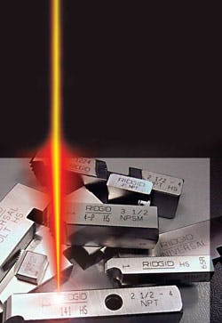

Laser marking of tools, workpieces and components offers advantages in many applications. The process is flexible, it offers several methods of permanently marking surfaces; it is a safe and environmentally friendly; it can be applied to flat, curved and unusually shaped objects made from any of a variety of materials and it can be used with materials that may be damaged by other marking methods.
Laser marking is a noncontact, thermal process relying on the heat generated by the laser beam to alter the surface of the workpiece. As its acronym name implies (Light Amplification by Stimulated Emission of Radiation), lasers amplify light by absorbing and emitting energy in the form of a high-intensity beam of laser light.

Solid-state Nd:YAG lasers are used to mark a variety of metallic and nonmetallic materials, and usually are used for beam-steered laser marking.
These systems deflect the laser beam across the surface much like a pencil on paper. Where the pencil deposits lead, the high-intensity laser light alters the workpiece material to create a contrasting image.
