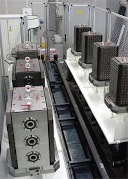

Zero point clamping system on a vertical machining center shuttle. Photo courtesy of BIG Kaiser Precision Tooling Inc. Effective management of a machine workspace and workholding devices goes a long way toward efficient ...

Zero-point clamping systems combine positioning and clamping into a single process. A retention knob with a geometric reference datum is appended to the workholding device or workpiece. The clamping process draws the retention knob into a ground reference that allows for simultaneous positioning and clamping. For small workspaces, a single retention location works well. Larger components can be held with multiple clamping locations.
Shuttle tables consist of a track mechanism that connects the machine table through a rail system to a table storage position. One workholding table can be shuttled out of the machine and a second table can be shuttled into the machine.
