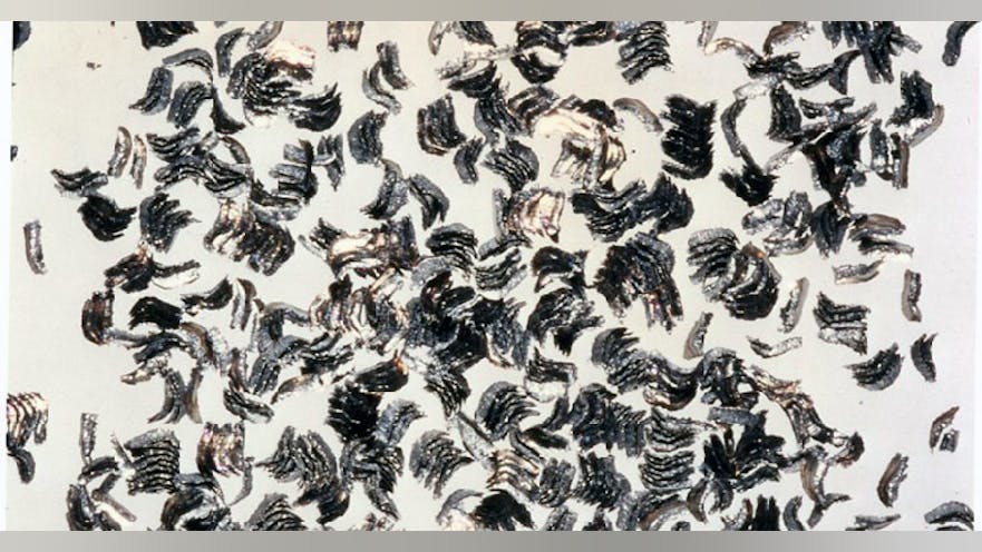

Chip Form: There have been machinability ratings based on the type of chip that is formed during the machining operation. The machinability might be judged by the ease of handling and disposing of chips. A material that produces long stringy chips would receive a low rating, as would one, which produces fine powdery chips. Materials, which inherently form nicely broken, chips, a half or full turn of the normal chip helix, would receive top rating. Chip handling and disposal can be quite expensive. Stringy chips are a menace to the operator and to the finish on the freshly machined surface. However, chip formation is a function of the machine variables as well as the workpiece material, and the ratings obtained by this method could be changed by provision of a suitable chip breaker.
Ratings based on the ease of chip disposal are basically qualitative, and would be judged by an individual who might assign letter gradings of some kind. Wide use is not made of this method of interpreting machinability. It finds some application in drilling, where good chip formation action is necessary to keep the chips running up the flutes. However, the whipping action of long coils once they are clear of the hole is undesirable. Chip formation and tool wear were discussed in Chapter 2.
