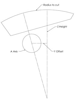

An example is cutting a large curved surface.
The radius of the main surface is 24 in. If you don’t have a lathe with a 24-in. swing, this becomes a difficult part to machine, never mind the large fixture it would take to hold the 8-in. by 14-in. by 3-in. piece of material. Setting this up on a fourth axis fixture makes machining the part practical.
Any point tangent to the surface can be calculated, and a Y, Z, A position for the machine can be determined.
First, calculate where the center of the arc of the part is in relation to the A axis.
Then, calculate where the tangent point is.
If you moved the A axis in tenths of a degree (above), imagine how many errors could be produced if you manually calculated that and entered the values into your program.
Using Excel, you can create an array (see the Excel Tips sidebar that accompanies this) that will do all this for you.
First, you need a series of numbers to represent the angles of the A axis.
To determine the angle of rotation required to complete the arc, use trigonometry:
SIN(a)=5/24, a=12.02, SIN(b)=9/24, b=22.02
Round the answer to 12.1 and 22.1, respectively.

The Y position is calculated as follows:
Sine of the angle X 18 (distance for center of A axis to arc center) Y=SIN(RADIANS (A$2:A$344))*18
The Z position is calculated by:
24(radius) minus the cosine of the angle times 18
Z=24-COS(RADIANS (A$2:A$344))*18.
