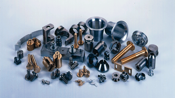

A selection of high-precision parts manufactured by Sinnotech GmbH.

Peter Simmet started the business 25 years ago, mainly supplying Bavarian automotive tier-one suppliers and the energy industry. Now, with his son Florian Simmet as owner and managing director, Sinnotech’s strength is its ability to deliver small, precision parts quickly, whether as prototypes or in series production.
